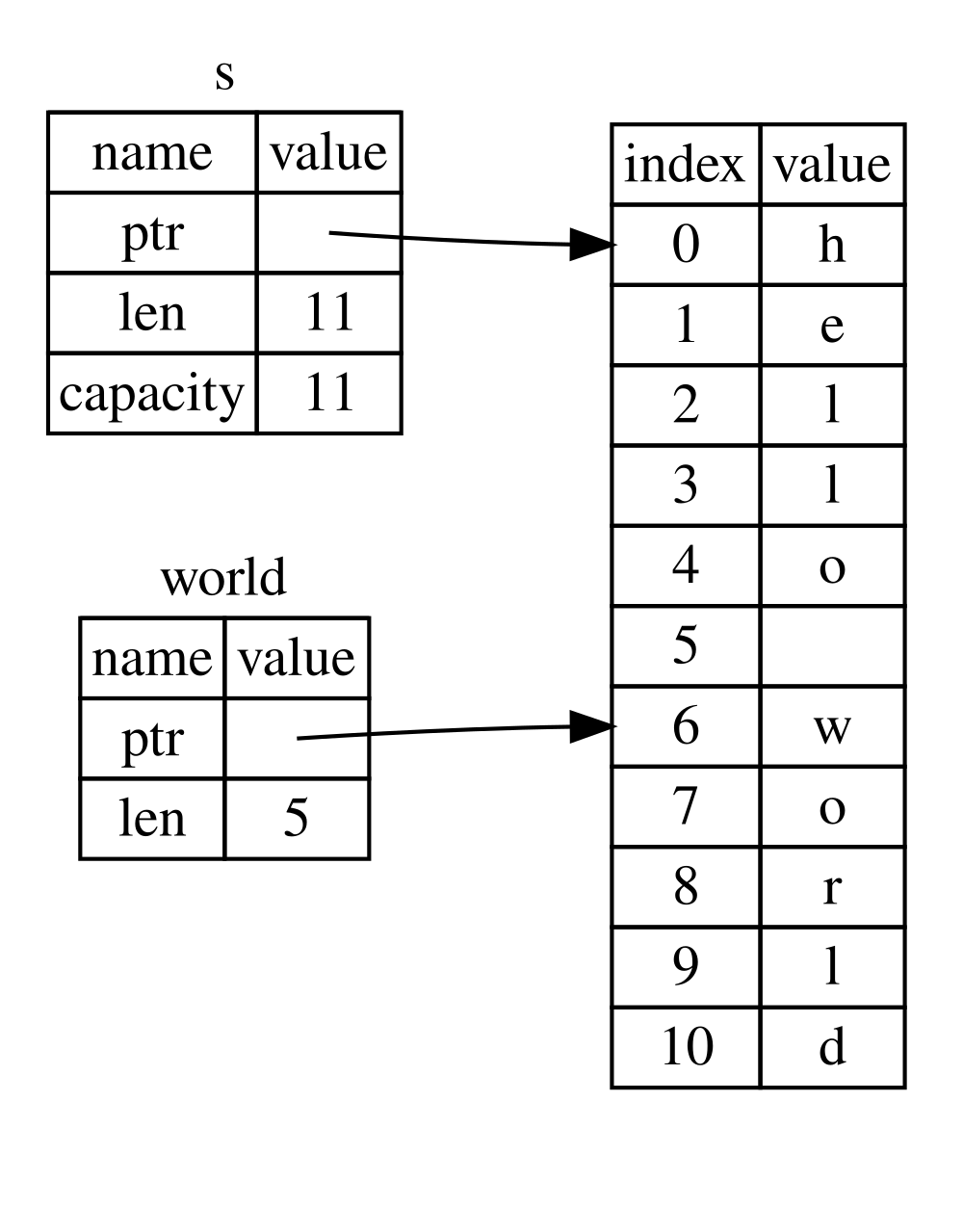

A first introduction to characters strings
For representing strings, Rust proposes two types: String and string slices (&str).
  • String is a powerful type, vector of UTF-8 bytes that can be muted, allocated on the heap.
  • &str is an immutable fat pointer (pointer + length) of UTF-8 bytes. It is often owned by something else: a String for instance.
For instance:
#![allow(unused)]
fn main() {
 let s = String::from("hello world");
   let hello = &s[0..5];
   let world = &s[6..11];
The example in memory (from Rust documentation, note the upper bound is one more that last element, array notation in Rust)
